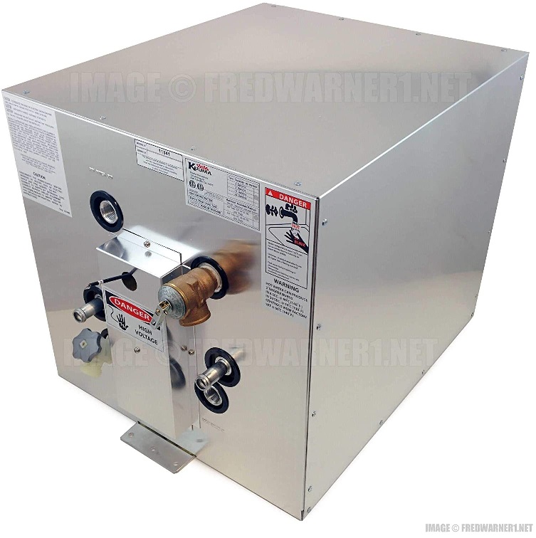

My hydronic heat storage consists of two ten gallon RV water heater tanks.
https://www.crystalpoint.com/cpdownl...aterHeater.jpg
The hydronic storage can be heated by:
1. External diesel boiler at the rear of the bus.
2. Engine coolant while driving.
3. Diesel Generator coolant (not yet hooked up).
4. Electric heat.

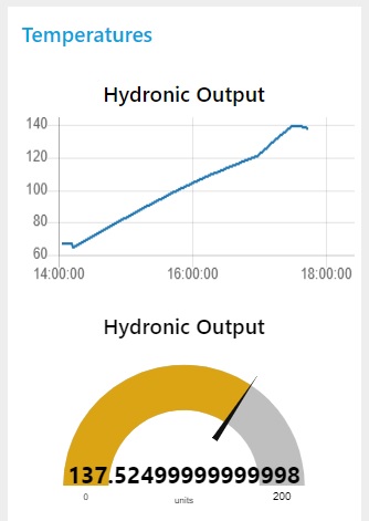

My current project is working on the charging control logic for when I am on shore power; so, I needed too dump some capacity out of the house battery; as the house battery pack was full up from solar charging.
So I remotely fired up the inverter and turned on power to the first tank, for my first test run of a load dump situation.
Currently I have 600 watts of solar panels just leaned up against the bus, but the goal is for 3KW of solar to be mounted on the roof; so dumping excess power to hot water should be a frequent occurrence.
In a driveway surfing situation with a 120V extension cord feed; I would say after three hours you could take a shower from a dead cold bus. OK in this graphic the start point was about 65 degrees and then was around 120 after three hours. The power draw for my selected RV water heater is about 1400 watts.
https://www.crystalpoint.com/cpdownl...ectricHeat.jpg
At 5PM I got tired of waiting and powered up the second tank to see where it would plateau at; which turned out to be 140 degrees for my tanks. I had noticed as I was wiring these heaters up; that there was no adjustment set point for the temperature.
So anyway you can see the effect of turning on the second tank heater; as a steeper slope at the end of graph.

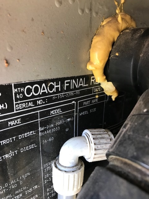

I was also curious about the state ID and did some research on this and found a web site that has listing for when buses were produced that may of be of interest for various manufactures:
It is: http://www.angelfire.com/ca/TORONTO/manufacturers.html Note you more and likely will have to use the internet history site to view this content.
In my case I was interested in Prevost buses produced in 1980 and got the following list of the motor homes:
[Private] Recker, O.E.S. JA80 Motor Home M104-2749-80
[Dealer] Liberty Coach Inc. MR80 Motor Home M104-2755-80
[Private] Beckley, G.W. MR80 Motor Home M104-2786-80
[Private] Miller, William & Elizabeth MY80 Motor Home M104-2796-80 35' Champion motor home
[Private] Custer, C.L. MY80 Motor Home M502-2806-80
[Private] Mandrell, Barbara MY80 Motor Home M104-2818-80 TN
[Private] Allavesen, Donald 1980 Motor Home M104-2826-80
I did find a data plate that matched up with this detail.
https://www.crystalpoint.com/cpdownl...usIdNumber.jpg
So no I don't think that I have a salvage title, probably just some weirdness of when it was registered in Oregon where I purchased it.
Thanks for the info. I did not know this was the way it used to be.

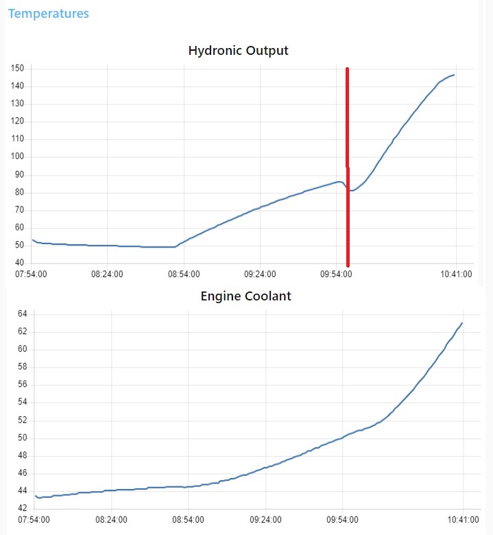

Did another baseline run this morning with electric vs diesel boiler preheating.
I have just about finished my solar install project with seven out of ten solar panels hooked up and it was forecasted to be sunny today (no evidence of it yet LOL!).
So anyway I needed to apply a dump load to drain the house batteries to make room for the solar power input.
It turned out to be a colder morning, forecasted to hit freezing tomorrow.
So anyway I turned on the electric heaters in both of the glycol storage tanks and was drawing about 3.4KW of power from the house battery bank for a bit over an hour.
At that point I turned them off and fired up the diesel boiler, which you can see from the red line that I drew on the chart.
https://www.crystalpoint.com/cpdownl...icVsDiesel.jpg
The initial dip in hydronic output temperature is due to diverting glycol back to the diesel boiler at the rear of the bus.
As you can see both curves steepened as the Diesel boiler is a 10KW unit.
