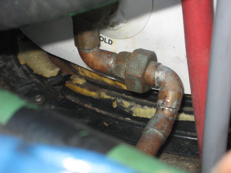

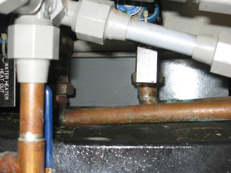

Funny that I just read this article again today while researching a solution to my headhunter toilet issue. It looks like I have the exact same problem as Jim Elmore, e.g. a 26" tank.
http://www.qrz.com/gifs/IMG_2471.JPG
http://www.qrz.com/gifs/IMG_2469.JPG
So far, no leaks and hot water works fine. I'm not sure if the heat exchanger is turned on or not, the valves didn't want to move in either direction. The base is definitely lifted up, just like Jims. I also checked the overpressure valve and it operates freely. My guess is that the heat exchanger probably causes this condition, along with age.
I'm on the road now in Minnesota and guess that I'll have to keep an eye on it for leaks until I can get it somewhere for repair. It's a long drive to Coach Worx, but I might get down that way in about 6 weeks. Although I'd love to fix this one myself, as in Tom's example, I just don't have the shop to do the work at home. So, it's off to find a qualified mechanic to do the work.
