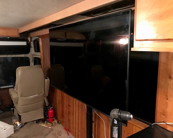

I first used this with my 75 inch TV (hey go big or go home...).
https://www.crystalpoint.com/cpdownl...reds/led75.jpg
However even I had to admit that it was too big in the bus, plus it weighted a lot and I was going to have to add a significant amount of bracing.
I had been wandering around Costco and noticed that there was a 55 inch OLED TV at a decent price and when you look at the screen portion it is only about 1/4 inch thick on top. The bottom is thicker as that's where electronics are. But hey it's a much lighter unit and you don't need two people to mount it or move it around.

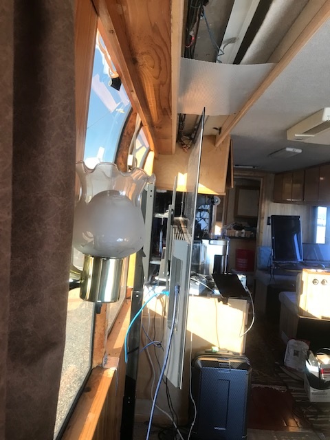

Here's a side view of the TV.
https://www.crystalpoint.com/cpdownl...eds/oled55.jpg

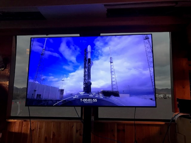

And a image of the screen:
https://www.crystalpoint.com/cpdownl...ledpicture.jpg
The above picture doesn't display the clarity that I get from this LG OLED TV, it also has an AI mode for the video and audio that does real well upscaling the video's that you get over a cellular data connection.
The lift is totally silent and had no problem with the the 75 inch TV which as I mentioned took two guys to move.
It's current position is based on centering the 75 inch TV, so I will be moving it to the left and closer to the wall. I will also adjust the mount so it will have a travel position when dropped down to the floor to rest on padding. Also in the dropped position it doesn't obstruct the windows.
I will also be creating a drop down desk in front of it, so it will be totally hidden unless in the raised position.

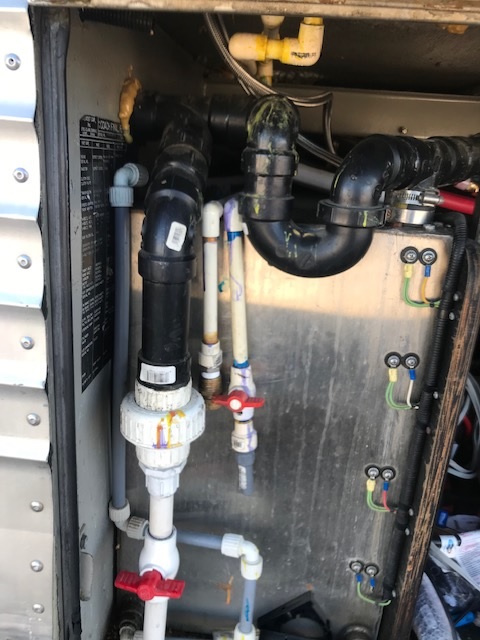

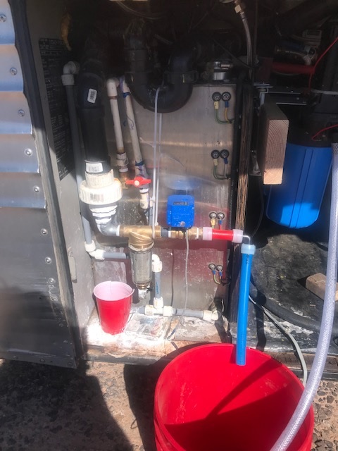

Here’s preliminary view of the plumbing for my recirculating shower, the bus originally came with a grey water shower dump valve.
https://www.crystalpoint.com/cpdownl...terOrginal.jpg
The way it was originally designed is that the pumping connection at the top routes the grey water into the downward pipe, when the valve is closed the water backs up and then goes through the water trap and into my grey/black water tank.

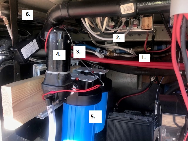

In my case I replaced the manual valve with a sediment filter and electrically driven valve that is normally closed.
https://www.crystalpoint.com/cpdownl...alveFilter.jpg
The rest of the system consists of:
1. Dual backflow check valve
2. Electrically driven auto closing three-way valve (normal shower when not activated)
3. Heat exchanger for hot water (kind of hidden in this picture)
4. RV style water pump
5. Dual filters
6. UV sterilizer
https://www.crystalpoint.com/cpdownl...howerStuff.jpg
Plumbing is done, now onto the electrical portion. Initially I will just use a five gallon bucket as the recirculation tank that you see in the second picture. Will custom build something else later.
The valve above the initial sediment filter gives access to fresh water to prime the recirculating system.

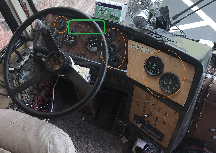

Ok just starting my next major project which is finishing a dash upgrade that a previous, previous owner started on and quit as soon as they had enough gauges to make it drivable.
https://www.crystalpoint.com/cpdownl...artingDash.jpg
As you can see in the above picture, only the gauges circled in orange are working and the idiot lights in green which are extremely hard to see.
This is something I have planned on doing for sometime and after experiencing the rats nest of wires that the PO left behind I was considering just making the jump to an electronic dash. Which will save a lot of time on my part.
After meeting Scott from the YouTube channel "This Old Bus" at the BCI rally; who is doing a similar conversion. I finally got kicked into high gear on this and now have a number of items on my bench to start testing/developing a replacement electronic dash solution for my bus.
I have a non-electronic 8V71TA engine in my bus, so the challenge is to get sensors wired up to some form of hub in the engine compartment that then sends out CANBUS messages to be displayed by the electronic dash.
The advantage of a CANBUS solution is that you will only need two wires for a signal data bus through out the vehicle.
If I had DDEC based engine. I would need is a protocol converter of some sort. But since I don't I will not expend any effort on that path.
Still going to maintain the current analog gauges that I now have as a backup.

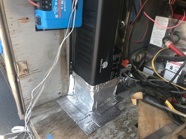

Ok the whole country heard that we had 110 degree weather here in the pacific northwest this last Monday; with the heat dome that was stuck over us.
Needless to say that it was a challenge with the bus also!!!
It turns out that when the cooling fan on my inverter comes on; it exhausts air out the bottom of the inverter, which then got sucked back in as it ross; so not much net cooling. Got to say I didn't think ahead about this when I installed the inverter..
So anyway the inverter tripped offline, resulting in no bloody air conditioning!!!
Had I been living in the bus, I would have been headed fast to somewhere I could plug it in to shore power and run the generator in the meantime.
It turns out there is a vent to the outside in the same area of the floor, so I created a duct to force the hot air outside.
https://www.crystalpoint.com/cpdownl...terAirDuct.jpg
To our relief the temperature dropped by 30 degrees on the next day.
