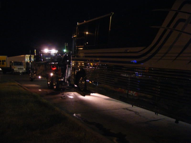

If you have to be hauled in, who better than the "3" wrecker. This guy was meticulous in every step. Over two hours getting her ready to go. The last of the antifreeze that came out was about 1/3 oil.
Thanks to Orren Zook for the info on his rebuild.
http://i72.photobucket.com/albums/i1...orme1/tow1.jpg
http://i72.photobucket.com/albums/i1...lorme1/tow.jpg
