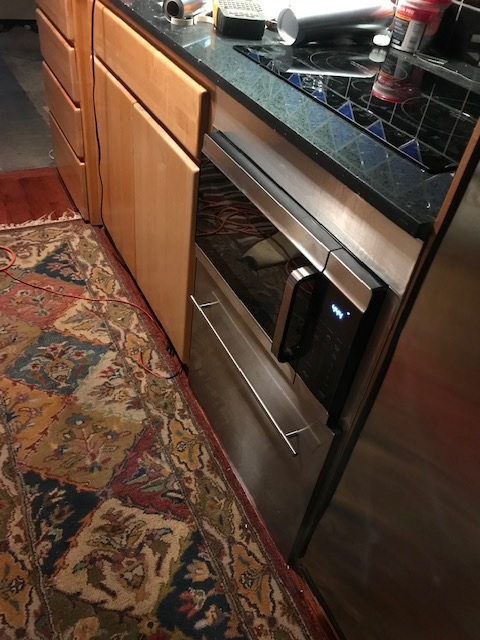

Ok a minor detour into the weeds from my basic make it functional route.
After getting the dishwasher and microwave installed the wood trim around it looked a bit out of place and I happened across a list of home improvements that had as one of it's items stainless steel wall paper to recover your appliances.
https://www.amazon.com/gp/product/B0...e?ie=UTF8&th=1
https://www.crystalpoint.com/cpdownl.../stainless.jpg
So at first glance it looks like I have custom stainless steel trim to finish out my appliance column.
However it didn't stick too well to wood; as I just wrapped it and didn't do any surface treatment, thinking it would work better on metal. Stainless steel shouldn't have a bubble here and there!!!
But hey it was only ten bucks and a bit of time!
Looks great!

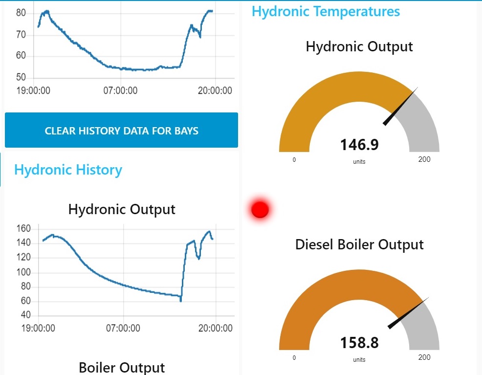

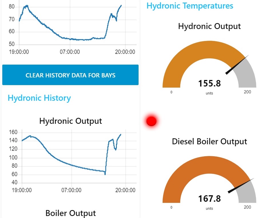

1. Diesel boiler runs at full power until the input temperature caches up with the output. At which point it throttles back. So, I will add an automation to detect this and automatically turn it off until the relight point is reached.
Running toward peek temperature:
https://www.crystalpoint.com/cpdownl...ronicRunUp.jpg
After the peak:
https://www.crystalpoint.com/cpdownl...eraturedip.jpg

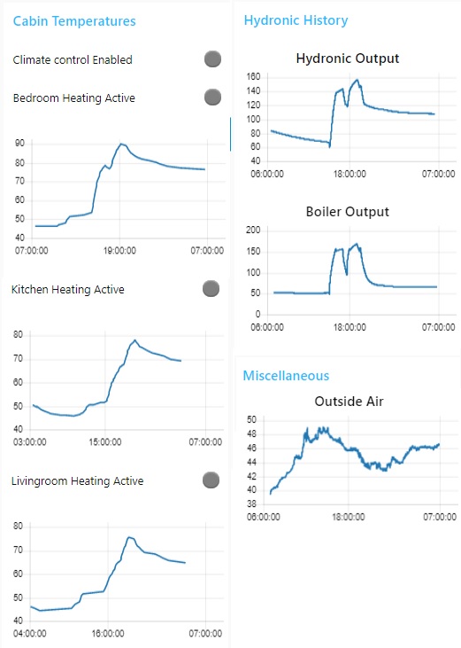

So anyway last night I ran the diesel boiler until it reached peak (no temperature control on the interior zones yet) and then turned on both water/glycol heaters with heat distribution to all zones and left the bus Moochdocking from two 120V outlets on separate circuits.
Here are the results (note the switch over was around 8PM):
https://www.crystalpoint.com/cpdownl...gOvernight.jpg
As you can see it fairly much held it's own, though it only got down to around 43 degrees last night. Just need to decide the criteria to decide when to kick in the diesel boiler assist for the automation logic.

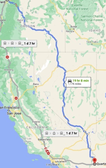

The route that I took from Seattle to Quartzite was a bit weird in that I took I-5 to Portland OR and then back roads direct which was mostly two-lane roads. Saw one patrol car in my entire trip.
I have seen discussion on the loneliest highway in Nevada and I would have to say that this route must have been the second loneliest highway as I went multiple times for at least 45 minutes before seeing someone coming from the other direction.
Probably not the wisest routing choice for my first long trip. But I have driven the route from Seattle down I-5 to the bay area, numerous times and I am a bit sick of it.
https://www.crystalpoint.com/cpdownl...zsiteRoute.jpg

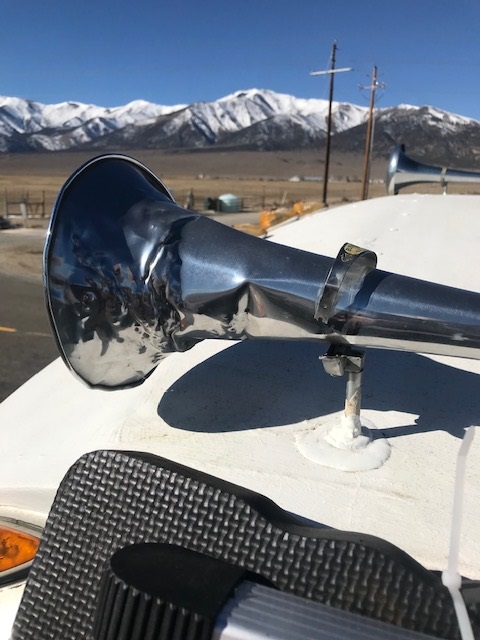

The only mechanical failure was a broken zip tie where one of my air horns had gotten crunched in the past by a previous owner.
https://www.crystalpoint.com/cpdownl...unchedHorn.jpg
