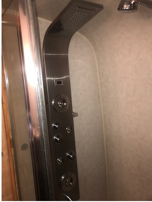

Anyway the next item on my wish list was a better shower.
https://www.crystalpoint.com/cpdownl.../NewShower.jpg

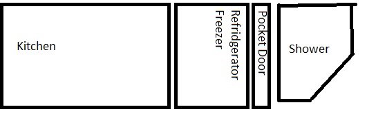

This was quite the install process as it didn't fit where the old shower head was. The layout of my bus in this area is:
https://www.crystalpoint.com/cpdownl...owerLayout.jpg

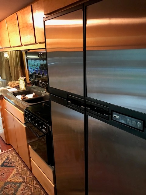

The refrigerator/freezer has been sitting in the aisle for sometime because I have been running my solar panel and network wiring on the rear wall. This space is a vertical column of the house battery bay, refrigerator/freezer and roof vent. The refrigerator/freezer is being converted from propane/electric to a simple DC compressor setup to eliminate propane in the bus and use 1/6 the electrical power.

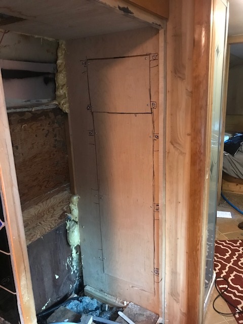

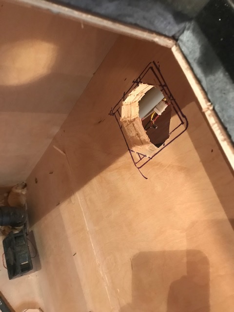

Anyway I had to cut through the wall of the cabinet that holds the refrigerator/freezer to get through the pocket door and then to the back of the shower to mount the new shower head.
https://www.crystalpoint.com/cpdownl...owerAccess.jpg

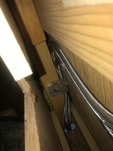

This is very tight space, so visited a number of hardware stores until I found some 72 inch stainless steel hoses so I wouldn't have a connection that I couldn't reach.
Also because of the sliding pocket door I had to be careful in routing these hoses so they wouldn't interfere with the pocket door.
https://www.crystalpoint.com/cpdownl...oseRouting.jpg

		Afterwards I filled my access cutout back in. Hey I am not a master carpenter and it's a very hidden sin LOL!!!!
https://www.crystalpoint.com/cpdownl...ssFilledIn.jpg
This shower will have two modes:
1. Normal shower
2. What I refer to as vertical hot tub mode where it is a recirculating shower. You can take a hour long hedonistic shower and not waste any water...
