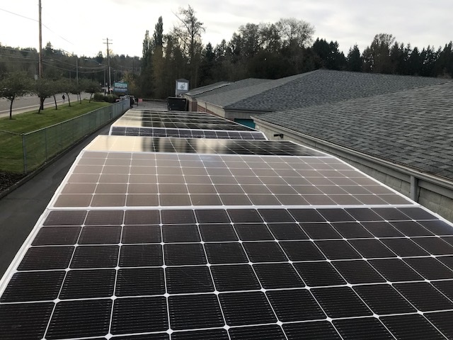

		Just finished a big project mounting the solar panels on my bus. I would say I averaged one panel a day for the installation as I was doing it by myself.
I installed ten LG375N2W-G4 panels on the top of my forty foot bus. These panels are 375 maximum watts apiece.

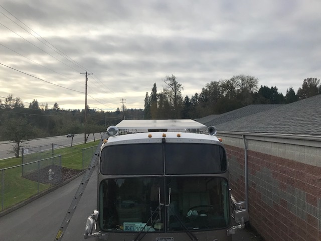

Here's the head on view from the front of the bus:
https://www.crystalpoint.com/cpdownl...SolarFront.jpg
Here's a view looking back along the top of the bus:
https://www.crystalpoint.com/cpdownl...larTopView.jpg

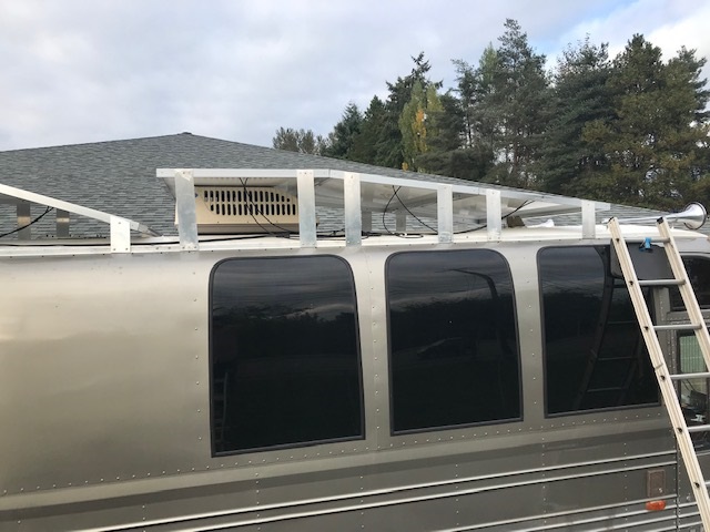

Here's a side view of the first three panels:
https://www.crystalpoint.com/cpdownl...arFontSide.jpg
In this view you can see that the first two panels are mounted in a slope for hopefully a little bit of aerodynamics though I know that this is probably a dead zone given the almost flat front ends on our buses.
This arrangement only adds about an inch to the clearance height of the bus. I didn't continue with the panels going straight back so as to give the air-conditioner hot exhaust a chance to go upwards and not heat the following panels which would affect their efficiency.
Given the poor aerodynamics of our buses all reports that I have heard is that there is no change in fuel efficiency for mounting solar panels. I don't have a base line on this bus, though the previous owner reported 9 MPG; which given his other statements I would discount.
Here's a side view of the last seven panels:
https://www.crystalpoint.com/cpdownl...arBackSide.jpg
Note the very last panel behind the rear air-conditioner is also mounted low to allow the hot air to raise.
I think a nice side effect of this arrangement is that the roof will be shaded and the solar panels should have good airflow to help cool them. Also most of the rain will hit the panels and then run off the sides.

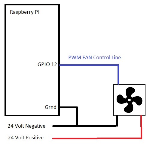

		DIY Hydronic system heater core's fan change over
		Well hey the bus now has heat since I got the zone fans working!!!
The bus was previously setup with each heater outlet having it's own manual fan control switch, can't have that with my automation/smart bus goal LOL!!!
Anyway I decided to change out the old fans with Noctua NF-F12 iPPC-24V-3000RPM Fans.
In the PC world Noctua has a great reputation for quite and long lasting fans. I went with 3000RPM fans for when I need maximum air movement.
This series of fans have what is called a four wire interface where the fan's speed is controlled with PWM (pulse wave modulation) signal.
The four wire interface has the following wires:
1. Ground
2. Power
3. PWM control
4. RPM feedback signal
https://www.crystalpoint.com/cpdownl...FanControl.jpg
I don't use the RPM feedback signal in my configuration.
In my DIY hydronic system I have multiple heat zones in the bus, with control of each zone done by switching the power on/off for the pump and the fan associated with the zone.
My bus automation controller is Raspberry Pi 4 running NodeRed. The Pi has two pins that can be assigned to do PWM under hardware control. However only one pin can be used at a time for PWM.
Given this I currently have the PWM control line shared by the different fans in each zone. I could add separate cheaper Raspberry Pi's and have each zone be adjustable.

If you are not doing automation you can purchase cheap add on PC fan controllers that you can manually adjust, otherwise when you give these fans power they run at full speed.
Another attribute of Noctua fans is that you can set the PWM duty cycle to zero and the fans turn off. Not something all generic PC fans can do.

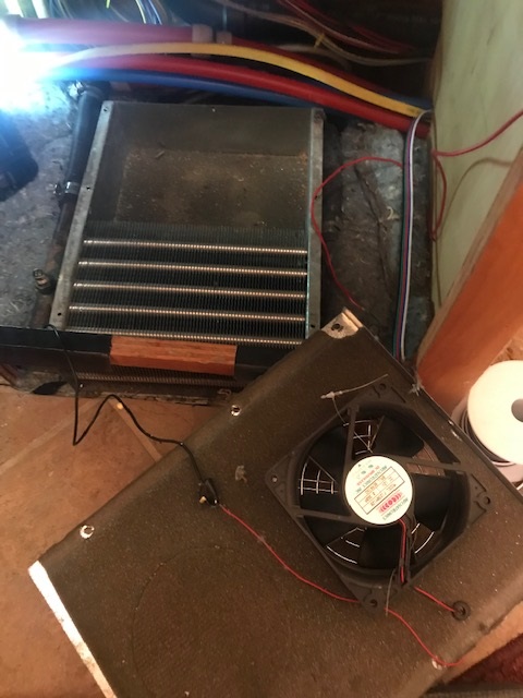

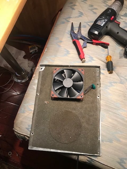

Anyway it was easy to change out the fans. Here's the old fan:
https://www.crystalpoint.com/cpdownl...aterOldFan.jpg
And the new Noctua fan:
https://www.crystalpoint.com/cpdownl...aterNewFan.jpg
Actually this last picture show's me accidently installing the fan backwards, opp's!!!
Test before you close up....

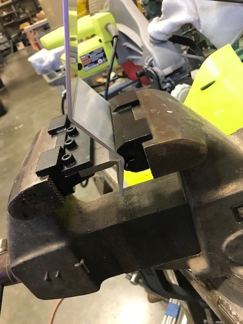

Anyway here's a picture of the offset brackets that I so proudly made to mount the first solar panel at the rear of the bus.
https://www.crystalpoint.com/cpdownl...setBracket.jpg
Using a bench vise you have to plan the order of the bends based on the distance between the top of the vice and the space to the draw bar. I used a vise mounted four inch metal brake from Harbor Freight.

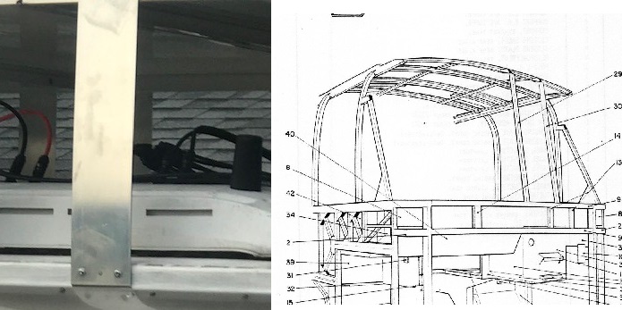

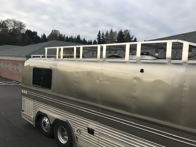

Like I mentioned earlier the my solar panels LG375N2W-G4 were an exact fit to use flat plates as standoff's on my bus. The previous owner had a very accurate paint line that was I able to key off of when installing these supports. The roof structure on my bus is aluminum sheets installed over a metal frame. This results in a hollow square tube that I could drill into to install rivnuts for mounting the panels.

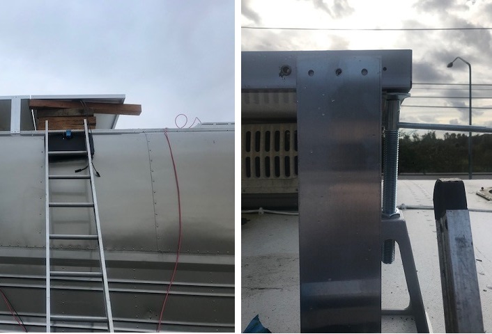

I was working alone so the next item on my learning list was how to get the panels properly into position!!!
https://www.crystalpoint.com/cpdownl...kingPanels.jpg
I started off using wooden blocks that I had on hand, however this lead to a comedy routine of going up and down ladders repeatedly on both sides of the bus. Which had friends commenting "hey have you lost weight?" to which I would say the answer was yes, lost count of the number of times I have been up and down those ladders!!!! The solution was to get light weight jack stands to accurately position the panels before starting to drill.
https://www.amazon.com/gp/product/B0...?ie=UTF8&psc=1

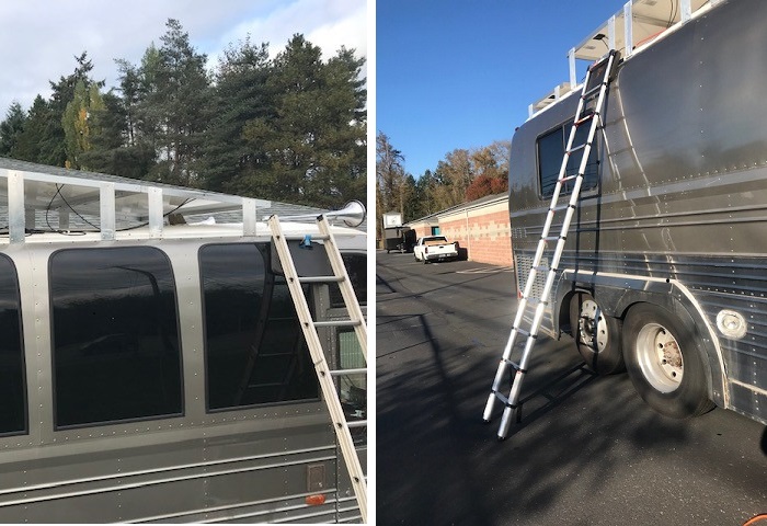

Speaking of ladders and proper tools. I initially started using an extension ladder that I had split into two pieces. In the case of my ladder this results in one piece missing a rung which I came very to regret as I had to position a step ladder next to that section to get past the missing rung. I just bet you can see this coming, but at the end of one day I forgot about the missing rung and wound up ringing my chime on the pavement!!!! I also sprained the thumb on my right hand which is still bothering me three weeks later.
https://www.crystalpoint.com/cpdownl...NewLadders.jpg
Needless to say I broke down and immediately purchased a telescopic extension ladder for the bus.
