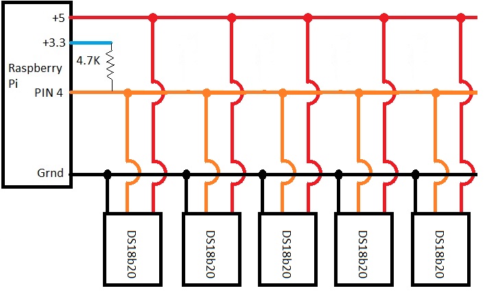

		I absolutely love One-Wire sensors and have made liberal use of them in my bus.
A One-Wire device communicates via a single signal pin and can work up to 200ft with twisted pair wiring. So just three wires to handle signal, power and ground that works as a distributed electrical sensor bus.
Here's how they are hooked up to my Raspberry Pi controller for the bus:

Each sensor has a unique ID that must be determined by adding one sensor at time and determining which id is the new one.

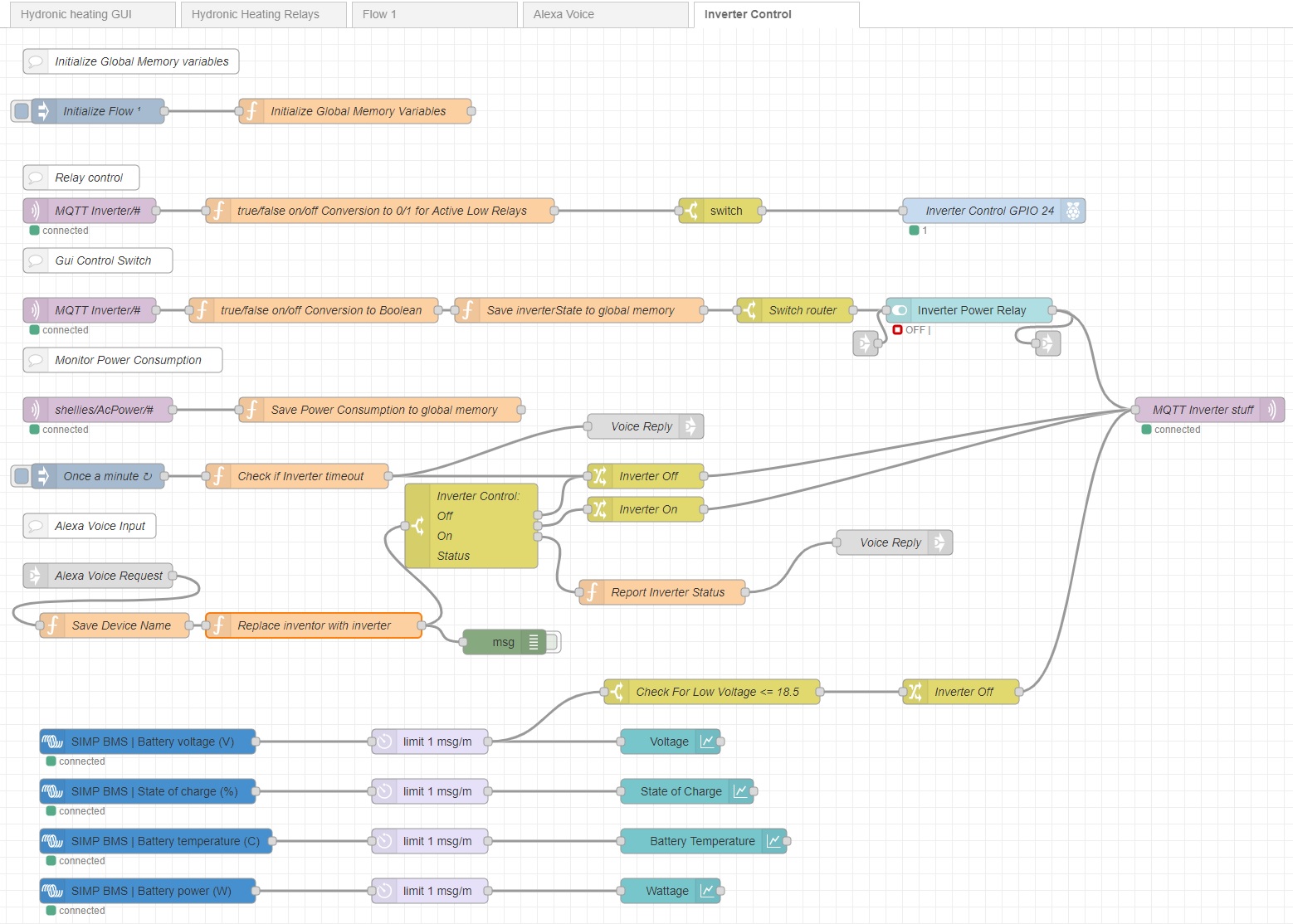

		I just added my first bit of automation bling to manage the AC power inverter on my bus.
https://www.crystalpoint.com/cpdownl...verterFlow.jpg
I have a high power inverter 6KW (up to 18KW surge) that has a standby consumption of about 100 watts. So if it is left on 24/7 it will use 2.4KW of power. Given that my house battery bank currently stores about 9KW, that can be a major chunk of the out of the storage capacity.
Obviously not as much of a problem when the sun is shining and is generating solar power.
So anyway this node-red flow monitors the inverter while it is on and automatically shuts it down; when it has been idle for ten minutes. If there is a large draw it automatically extends the time period.

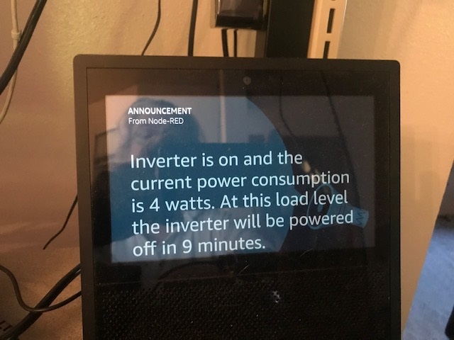

Alexa responses OK to the off and on commands. For the status command it says OK and then does an announcement with the current status.
https://www.crystalpoint.com/cpdownl...tatusAlexa.jpg

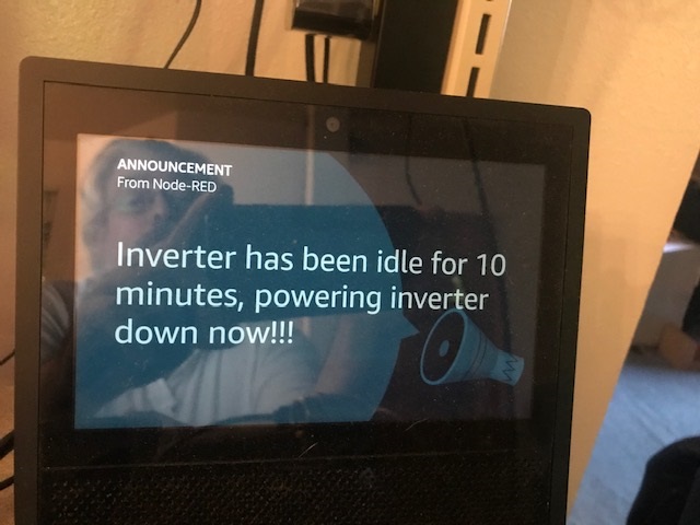

When it automatically shuts down the inverter; it does another announcement "Ding, message". On my Alexa show it also shows the text besides speaking it.
https://www.crystalpoint.com/cpdownl...flineAlexa.jpg
